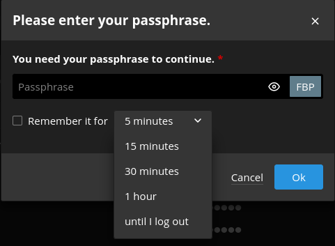

The best way to keep your session active is via the remember me feature as shown here.
Remember my password
fig. Remember my password
