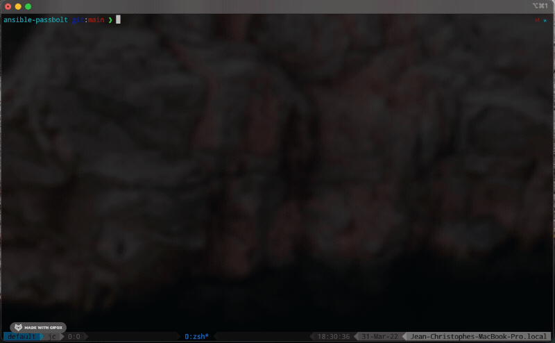

aws_secret_access_key={{ aws.secret_key }}We hope this article gave you the hitch to take the passbolt and ansible for spin. To simplify this, we place the code used in this article in an example repository. In this repository you will find a docker-compose.yml file that will create a small passbolt instance ready to play with ansible.
Clone the project:
git clone [email protected]:passbolt/lab-passbolt-ansible-poc.gitLaunch the stack:
cd lab-passbolt-ansible-poc
docker-compose up -dJump in the ansible container:
docker-compose run ansibleYou are now good to launch the ansible playbook to see it in action!
ansible-playbook playbooks/example-playbook.yml
