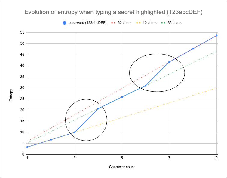

Let's assume we'll have to break the following password: `123abcDEF`.
"How scandalous sir! We know the password therefore there is no information to recover and the entropy is null!"
Wow, you read the first article right? That's a real pleasure to see. But, let's pretend we don't know it just for the example please.
✨ Invoking some magical graphs right now! ✨
On the chart, we see 4 curves, the straight ones are the evolution of entropy given a mask size and different password lengths. The one on top of the others is the entropy evolution of the password we want to break.
From the final entropy of the password we could know that it is composed of 9 characters and from a set of 62 characters.
We can also notice the following:
- The 3 first characters follow the first curve
- The second set of 3 characters are following the second curve
- The 3 last characters are following the last curve.
- The final entropy of the password confirms it's a 9 character long password and that it uses 62 different characters
- There are jumps on the curve for the characters 4 and 7.
This matches the password pattern we have:
- 3 digits
- 3 small letters
- 3 capital letters
- characters 4 and 7 are characters from a new set
Based on that we can deduce the size of the character set for each character. Moreover, each character that produces a jump on another curve is part of the additional character set only and not the entire character set.
It means that we can have an idea of the structure of the password with its entropy evolution.
